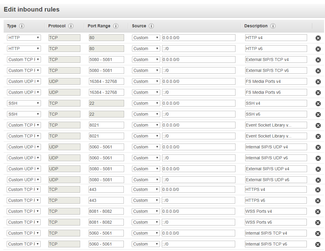

Firewall
Typical Ports
FireWall Ports Network Protocol Application Protocol Description
1719 UDP H.323 Gatekeeper RAS port
1720 TCP H.323 Call Signaling
2855-2856 TCP MSRP Used for call with messaging
3478 UDP STUN service Used for NAT traversal
3479 UDP STUN service Used for NAT traversal
5002 TCP MLP protocol server
5003 UDP Neighborhood service
5060 UDP & TCP SIP UAS Used for SIP signaling (Standard SIP Port, for default Internal Profile)
5070 UDP & TCP SIP UAS Used for SIP signaling (For default “NAT” Profile)
5080 UDP & TCP SIP UAS Used for SIP signaling (For default “External” Profile)
8021 TCP ESL Used for mod_event_socket *****
16384-32768 UDP RTP/ RTCP multimedia streaming Used for audio/video data in SIP, Verto, and other protocols
5066 TCP Websocket Used for WebRTC
7443 TCP Websocket Used for WebRTC
8081-8082 TCP Websocket Used for Verto
ESL SECURITY RISK
Think carefully about opening the ESL port to the external world and change the default password. ESL allows any system commands to be run or even to crash FreeSWITCH for call recovery testing. Allowing public access is therefore a security risk.
Amazon EC2
:warning: ウェブソケットやSIPのTLS接続に必要な認証ファイルの作成については、以下WebRTCの記事も参照のこと(右下の ↑ をクリック)。
