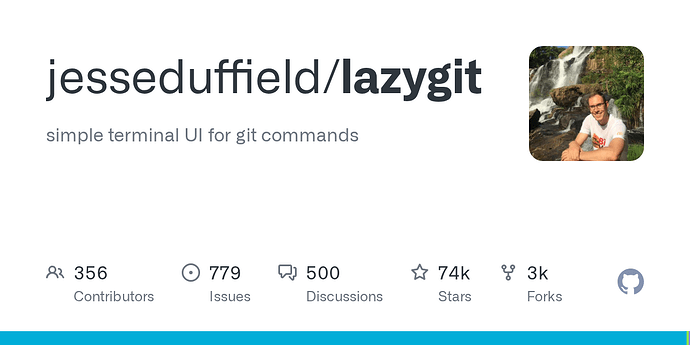

lazygit
gitの操作を視覚的に把握・実行できる便利はツールです。
Ubuntu24.04ではバイナリからインストールする必要があります。現時点での最新版はv0.58です。
ダウンロード
https://github.com/jesseduffield/lazygit/releases/download/v0.58.0/lazygit_0.58.0_linux_x86_64.tar.gz
解凍してインストール
$ cd lazygit_0.58.0_linux_x86_64
$ sudo install lazygit /usr/local/bin
コマンドオプション
$ lazygit -h
  Usage:
    lazygit [git-arg]
  Positional Variables:
    git-arg   Panel to focus upon opening lazygit. Accepted values (based on git terminology): status, branch, log, stash. Ignored if --filter arg is passed.
  Flags:
    -h --help               Displays help with available flag, subcommand, and positional value parameters.
    -p --path               Path of git repo. (equivalent to --work-tree=<path> --git-dir=<path>/.git/)
    -f --filter             Path to filter on in `git log -- <path>`. When in filter mode, the commits, reflog, and stash are filtered based on the given path, and some operations are restricted
    -v --version            Print the current version
    -d --debug              Run in debug mode with logging (see --logs flag below). Use the LOG_LEVEL env var to set the log level (debug/info/warn/error)
    -l --logs               Tail lazygit logs (intended to be used when `lazygit --debug` is called in a separate terminal tab)
       --profile            Start the profiler and serve it on http port 6060. See CONTRIBUTING.md for more info.
    -c --config             Print the default config
    -cd --print-config-dir   Print the config directory
    -ucd --use-config-dir     override default config directory with provided directory
    -w --work-tree          equivalent of the --work-tree git argument
    -g --git-dir            equivalent of the --git-dir git argument
    -ucf --use-config-file    Comma separated list to custom config file(s)
    -sm --screen-mode        The initial screen-mode, which determines the size of the focused panel. Valid options: 'normal' (default), 'half', 'full'
