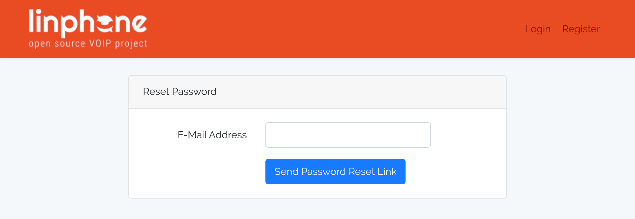

パスワードリセットコントローラ app/Http/Controllers/Auth/ResetPasswordController.php 内で使用されているトレイトを App\Traits\ResetsPasswords へ変更し、 app/Traits/ResetsPasswords.php と、このトレイト内で使用されている app/Traits/RedirectsUsers.php を作成します。
namespace App\Traits;
use Illuminate\Auth\Events\PasswordReset;
use Illuminate\Http\JsonResponse;
use Illuminate\Http\Request;
use Illuminate\Support\Facades\Auth;
use Illuminate\Support\Facades\Hash;
use Illuminate\Support\Facades\Password;
use Illuminate\Support\Str;
use Illuminate\Validation\ValidationException;
trait ResetsPasswords
    use RedirectsUsers;
     * Display the password reset view for the given token.
     * If no token is present, display the link request form.
     * @param  \Illuminate\Http\Request  $request
     * @param  string|null  $token
     * @return \Illuminate\Contracts\View\Factory|\Illuminate\View\View
    public function showResetForm(Request $request, $token = null)
        return view('auth.passwords.reset')->with(
            ['token' => $token, 'email' => $request->email]
     * Reset the given user's password.
     * @return \Illuminate\Http\RedirectResponse|\Illuminate\Http\JsonResponse
    public function reset(Request $request)
        $request->validate($this->rules(), $this->validationErrorMessages());
        // Here we will attempt to reset the user's password. If it is successful we
        // will update the password on an actual user model and persist it to the
        // database. Otherwise we will parse the error and return the response.
        $response = $this->broker()->reset(
            $this->credentials($request), function ($user, $password) {
                $this->resetPassword($user, $password);
        // If the password was successfully reset, we will redirect the user back to
        // the application's home authenticated view. If there is an error we can
        // redirect them back to where they came from with their error message.
        return $response == Password::PASSWORD_RESET
                    ? $this->sendResetResponse($request, $response)
                    : $this->sendResetFailedResponse($request, $response);
     * Get the password reset validation rules.
     * @return array
    protected function rules()
        return [
            'token' => 'required',
            'email' => 'required|email',
            'password' => 'required|confirmed|min:8',
     * Get the password reset validation error messages.
     * @return array
    protected function validationErrorMessages()
        return [];
     * Get the password reset credentials from the request.
     * @return array
    protected function credentials(Request $request)
        return $request->only(
            'email', 'password', 'password_confirmation', 'token'
     * @param  \Illuminate\Contracts\Auth\CanResetPassword  $user
     * @param  string  $password
     * @return void
    protected function resetPassword($user, $password)
        $this->setUserPassword($user, $password);
        $user->setRememberToken(Str::random(60));
        $user->password->save();
        $user->save();
        event(new PasswordReset($user));
        $this->guard()->login($user);
     * Set the user's password.
     * @return void
    protected function setUserPassword($user, $password)
        $username = $user->username;
        $domain = $user->domain;
        $user->password->password = hash('sha256', $username.':'.$domain.':'.$password);
        //dd($user);
     * Get the response for a successful password reset.
     * @param  string  $response
    protected function sendResetResponse(Request $request, $response)
        if ($request->wantsJson()) {
            return new JsonResponse(['message' => trans($response)], 200);
        return redirect($this->redirectPath())
                            ->with('status', trans($response));
     * Get the response for a failed password reset.
    protected function sendResetFailedResponse(Request $request, $response)
            throw ValidationException::withMessages([
                'email' => [trans($response)],
        return redirect()->back()
                    ->withInput($request->only('email'))
                    ->withErrors(['email' => trans($response)]);
     * Get the broker to be used during password reset.
     * @return \Illuminate\Contracts\Auth\PasswordBroker
    public function broker()
        return Password::broker();
     * Get the guard to be used during password reset.
     * @return \Illuminate\Contracts\Auth\StatefulGuard
    protected function guard()
        return Auth::guard();
