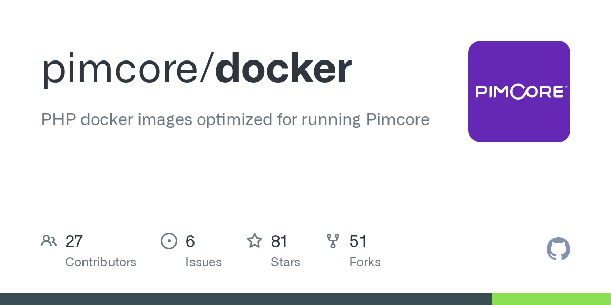

Docker ImageについてはGitHubでも配布
  • [min] PHP image for FPM and CLI with minimum requirements (e.g. php8.2-min-latest)
  • [default] PHP image for FPM and CLI incl. all optional dependencies (e.g. php8.2-latest or php8.2-default-latest)
  • [max] PHP image for FPM and CLI incl. all optional dependencies and additional extensions and software (e.g. php8.2-max-latest)
  • [debug] PHP debug image based on PHP image above, including preconfigured Xdebug for FPM and CLI (e.g. php8.2-debug-latest)
  • [supervisord] Supervisord image based on PHP image above, for cron & queue processing (e.g. php8.2-supervisord-latest)
従来の PHP8.1-fpm イメージは php8.1-latest (defaultの場合)となります。
$ docker pull pimcore/pimcore:php8.1-latest
