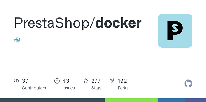

PrestaShop + Docker
GitHub Docker Prestashop
DockerHub Prestashop
