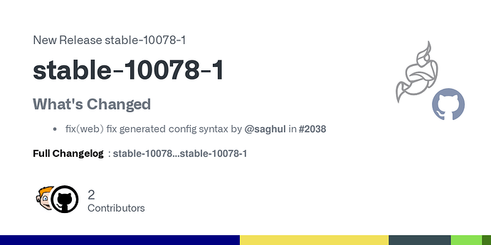

最新安定版の導入
省略していたSIPゲートウェイJigasiコンテナを追加(音声のみ対応)し、最新安定版として再構築。
最新安定版10078-1

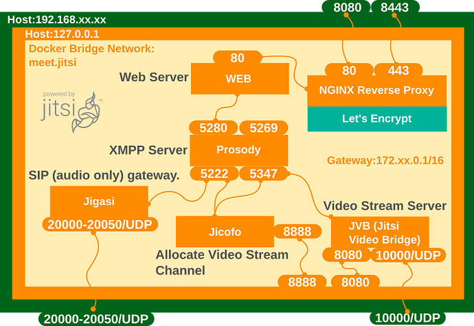

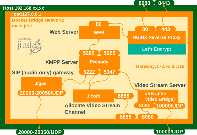

構成コンテナイメージとポートの確認
  • base: Debian stable base image with the S6 Overlay for process control and the Jitsi repositories enabled. All other images are based on this one.
  • base-java: Same as the above, plus Java (OpenJDK).
  • web: Jitsi Meet web UI, served with nginx.
  • prosody: Prosody, the XMPP server.
  • jicofo: Jicofo, the XMPP focus component.
  • jvb: Jitsi Videobridge, the video router.
  • jigasi: Jigasi, the SIP (audio only) gateway.
  • jibri: Jibri, the broadcasting infrastructure.
Prosody
https://prosody.im/doc/ports
port interfaces service
5000/tcp public File transfer proxy
5222/tcp public Client connections
5269/tcp public Server-to-server connections
5280/tcp private1 HTTP
5281/tcp public HTTPS
5347/tcp private External components
5582/tcp private Telnet console

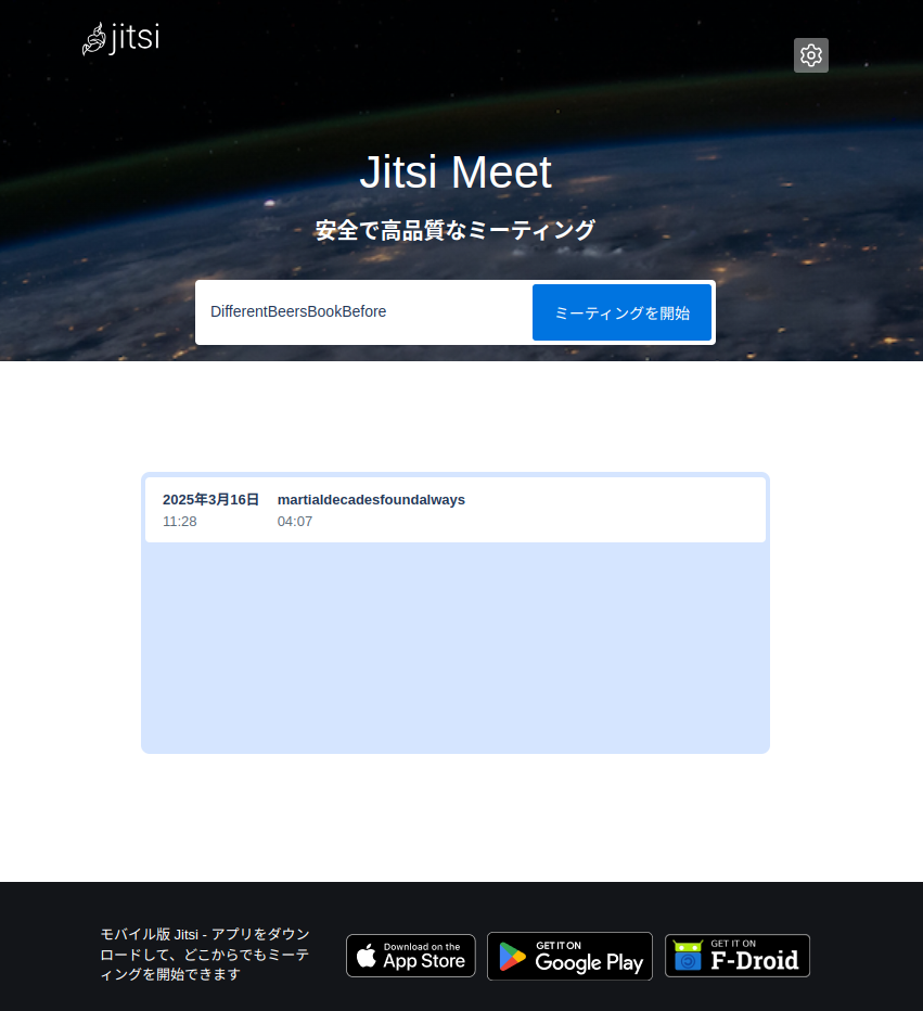

Jitsiメイン画面

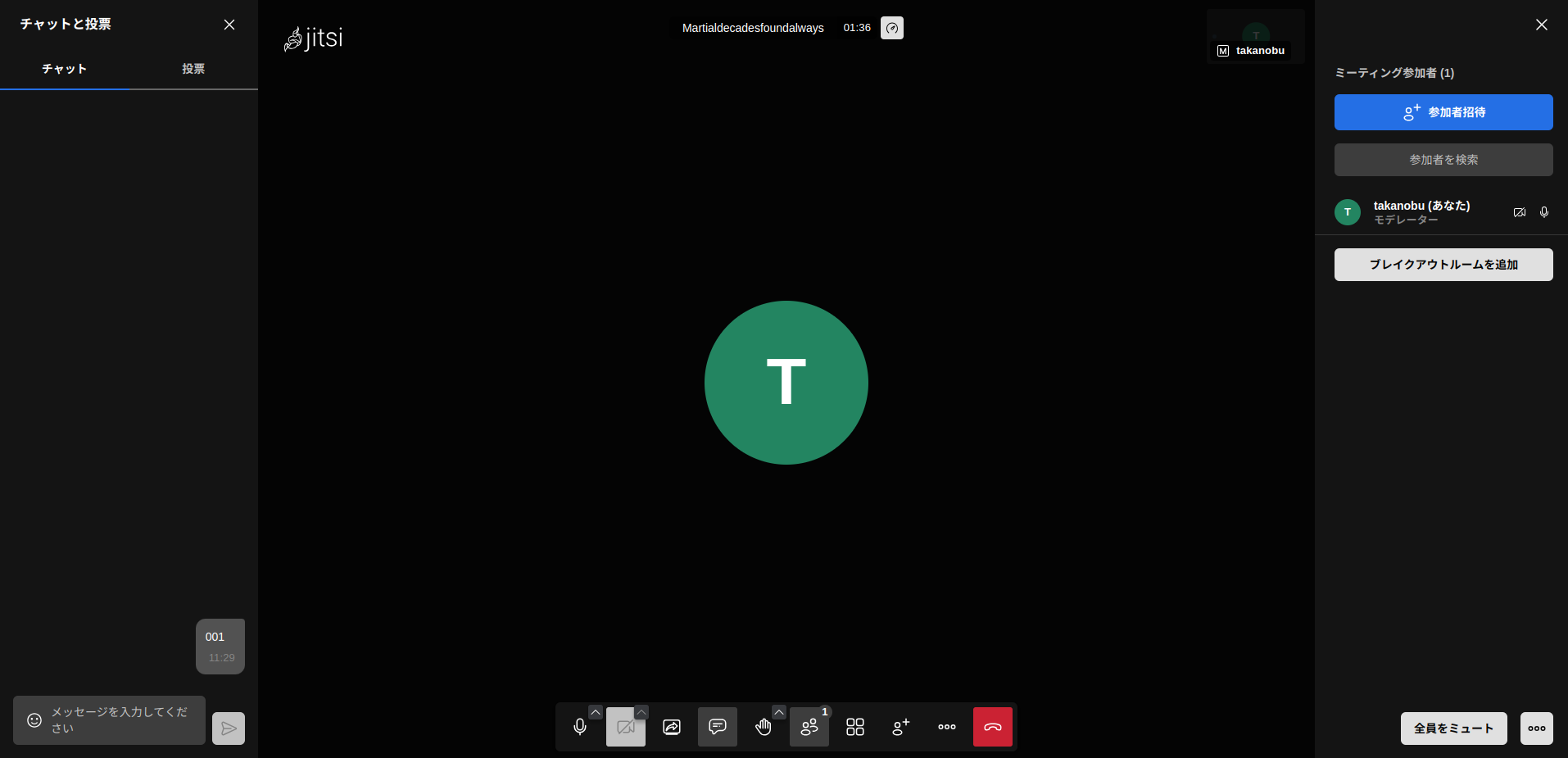

ミーティング画面
