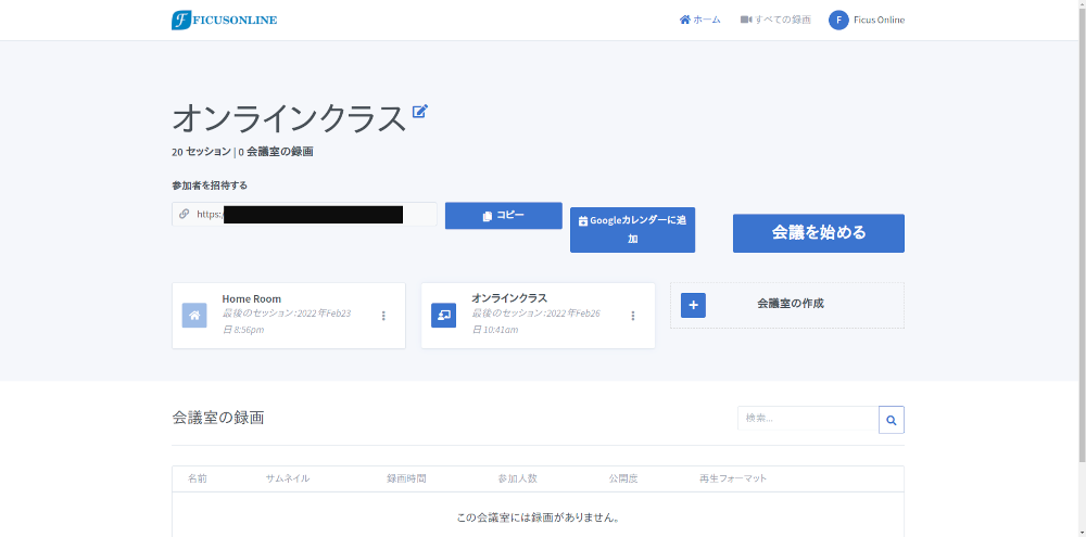

Docker-Composeファイル環境変数設定ファイル.envファイル作成スクリプトの実行
DockerイメージによりCertbotをスタンドアローンモードで起動。TLS認証を取得(coturnで必要)後Docker-Compose起動に必要な .env ファイル作成のため下記スクリプトを実行。
$ ./scripts/setup
Should greenlight be included? (y/n): y
Should an automatic HTTPS Proxy be included? (y/n): n
Should a coturn be included? (y/n): y
Coturn needs TLS to function properly.
Since automatic HTTPS Proxy is disabled,
you must provide a relative or absolute path
to your certificates.
Please enter path to cert.pem: ../letsencrypt/live/xx.xx.xx/cert.pem
Please enter path to key.pem: ../letsencrypt/live/xx.xx.xx/privkey.pem
Please enter the domain name: f9e.duckdns.org
Should the recording feature be included?
IMPORTANT: this is currently a big privacy issues, because it will
record everything which happens in the conference, even when the button
suggests, that it does not.
make sure that you always get people's consent, before they join a room!
https://github.com/bigbluebutton/bigbluebutton/issues/9202
Choice (y/n): y
Should a Prometheus exporter be included? (y/n): n
Should old recordings be removed? (y/n): y
Please enter max age(days) for keeping recordings: 1
Is xx.xx.xx.xx your external IPv4 address? (y/n): y
Unable to find image 'jwilder/dockerize:latest' locally
latest: Pulling from jwilder/dockerize
88286f41530e: Pulling fs layer
3cabffebe5fe: Pulling fs layer
88286f41530e: Download complete
88286f41530e: Pull complete
3cabffebe5fe: Verifying Checksum
3cabffebe5fe: Download complete
3cabffebe5fe: Pull complete
Digest: sha256:b4da07ad265d2dd83fc91a73f56df54def78ba3db5c4fb74cbb9b7e79b7b3c58
Status: Downloaded newer image for jwilder/dockerize:latest
configuration file .env got successfully created!
you can look through it for further adjusments
$ nano .env
make sure to recreate the docker-compose.yml after each change
$ ./scripts/generate-compose
to start bigbluebutton run

メイン画面

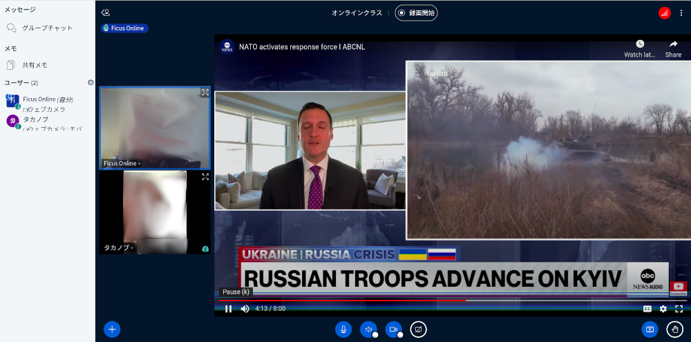

オンラインクラスでYouTube画面共有

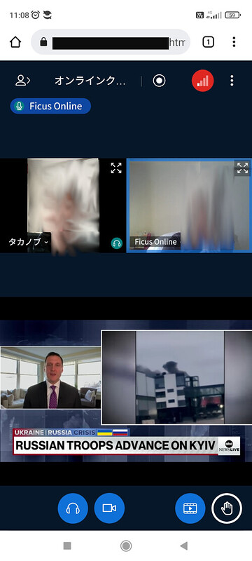

モバイルからのアクセス

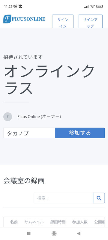

モバイルからオンラインクラスへ参加
注) ネットワークのレベルゲージが赤になっているのは、あえて低スループットにしているためです。ホストマシンの処理能力次第ですが、数十人程度の同時参加は出来るようです。
