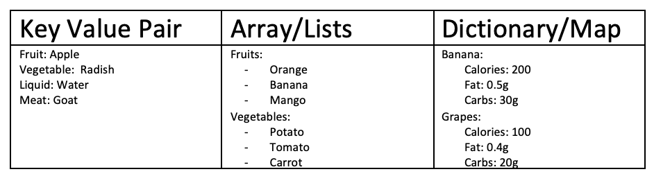

YAML basics in Kubernetes
参考)yamlの構文ルール
  1. Key Value Pair — The basic type of entry in a YAML file is of a key value pair. After the Key and colon there is a space and then the value.
  2. Arrays/Lists — Lists would have a number of items listed under the name of the list. The elements of the list would start with a -. There can be a n of lists, however the indentation of various elements of the array matters a lot.
  3. Dictionary/Map — A more complex type of YAML file would be a Dictionary and Map.

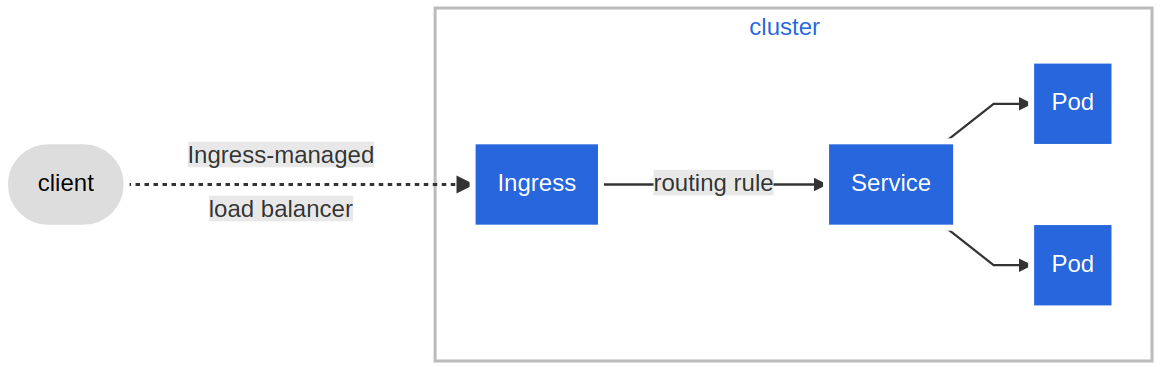

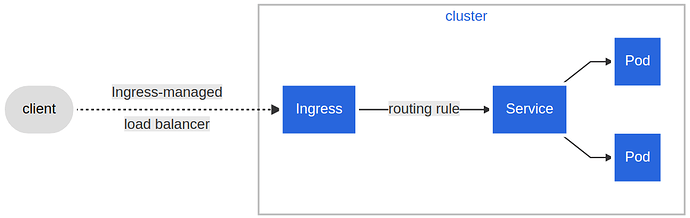

Ingress
Name-Based Virtual Hosting
Ingress によりホスト名でアクセスするサーバを振分ける

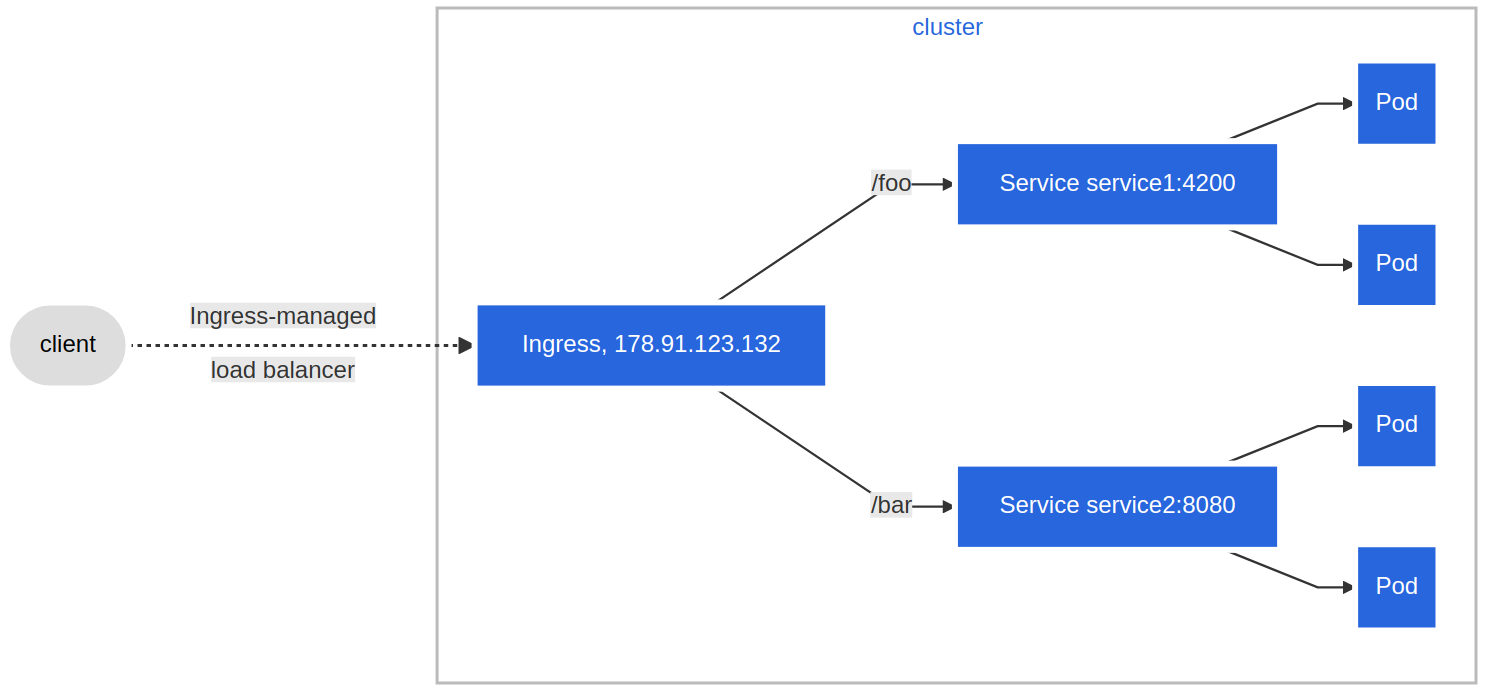

Fanout
Ingress によりホストのディレクトリでアクセスするサーバを振分ける
