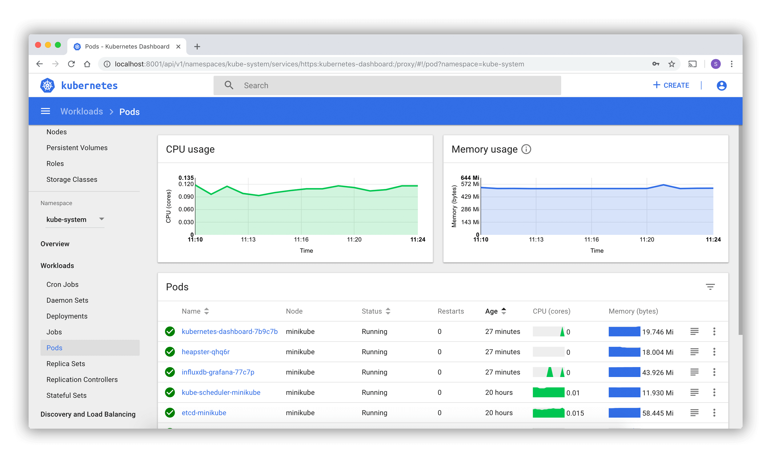

Kubernetesダッシュボードの起動
$ minikube dashboard
🔌  ダッシュボードを有効化しています...
    ▪ kubernetesui/metrics-scraper:v1.0.8 イメージを使用しています
    ▪ kubernetesui/dashboard:v2.6.0 イメージを使用しています
🤔  ダッシュボードの状態を検証しています...
🚀  プロキシーを起動しています...
🤔  プロキシーの状態を検証しています...
🎉  デフォルトブラウザーで http://127.0.0.1:34475/api/v1/namespaces/kubernetes-dashboard/services/http:kubernetes-dashboard:/proxy/ を開いています...
libva error: vaGetDriverNameByIndex() failed with unknown libva error, driver_name = (null)
既存のブラウザ セッションで開いています。

Kubernetesダッシュボード
minikubeアドオンリスト
$ minikube addons list
|         ADDON NAME          | PROFILE  |    STATUS    |           MAINTAINER           |
| ambassador                  | minikube | disabled     | 3rd party (Ambassador)         |
| auto-pause                  | minikube | disabled     | Google                         |
| csi-hostpath-driver         | minikube | disabled     | Kubernetes                     |
| dashboard                   | minikube | enabled ✅   | Kubernetes                     |
| default-storageclass        | minikube | enabled ✅   | Kubernetes                     |
| efk                         | minikube | disabled     | 3rd party (Elastic)            |
| freshpod                    | minikube | disabled     | Google                         |
| gcp-auth                    | minikube | disabled     | Google                         |
| gvisor                      | minikube | disabled     | Google                         |
| headlamp                    | minikube | disabled     | 3rd party (kinvolk.io)         |
| helm-tiller                 | minikube | disabled     | 3rd party (Helm)               |
| inaccel                     | minikube | disabled     | 3rd party (InAccel             |
|                             |          |              | [[email protected]])            |
| ingress                     | minikube | disabled     | Kubernetes                     |
| ingress-dns                 | minikube | disabled     | Google                         |
| istio                       | minikube | disabled     | 3rd party (Istio)              |
| istio-provisioner           | minikube | disabled     | 3rd party (Istio)              |
| kong                        | minikube | disabled     | 3rd party (Kong HQ)            |
| kubevirt                    | minikube | disabled     | 3rd party (KubeVirt)           |
| logviewer                   | minikube | disabled     | 3rd party (unknown)            |
| metallb                     | minikube | disabled     | 3rd party (MetalLB)            |
| metrics-server              | minikube | disabled     | Kubernetes                     |
| nvidia-driver-installer     | minikube | disabled     | Google                         |
| nvidia-gpu-device-plugin    | minikube | disabled     | 3rd party (Nvidia)             |
| olm                         | minikube | disabled     | 3rd party (Operator Framework) |
| pod-security-policy         | minikube | disabled     | 3rd party (unknown)            |
| portainer                   | minikube | disabled     | 3rd party (Portainer.io)       |
| registry                    | minikube | disabled     | Google                         |
| registry-aliases            | minikube | disabled     | 3rd party (unknown)            |
| registry-creds              | minikube | disabled     | 3rd party (UPMC Enterprises)   |
| storage-provisioner         | minikube | enabled ✅   | Google                         |
| storage-provisioner-gluster | minikube | disabled     | 3rd party (Gluster)            |
| volumesnapshots             | minikube | disabled     | Kubernetes                     |
💡  他のプロファイル用のアドオン一覧を表示するためには、`minikube addons -p name list` を実行します
metric-serverアドオンの有効化
$ minikube addons enable metrics-server
ダッシュボード起動
🚀  プロキシーを起動しています...
🎉  デフォルトブラウザーで http://127.0.0.1:45927/api/v1/namespaces/kubernetes-dashboard/services/http:kubernetes-dashboard:/proxy/ を開いています...
