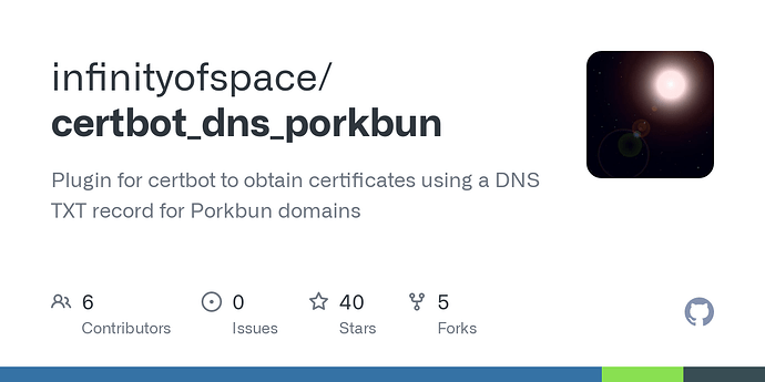

Porkbun Certbot DNS認証プラグイン
PorkbunからAPIキーを取得しporkbun.iniファイルを作成。(アクセス権は600)
porkbun.ini
dns_porkbun_key=<your-porkbun-api-key>
dns_porkbun_secret=<your-porkbun-api-secret>
DockerによりPorkbun Certbotプラグイン実行
$ docker run -it --rm --name certbot_porkbun -v "$PWD/letsencrypt:/etc/letsencrypt" -v "/var/log/letsencrypt:/var/log/letsencrypt" -v "$PWD/porkbun.ini:/conf/porkbun.ini" infinityofspace/certbot_dns_porkbun:latest \
certonly \
--non-interactive \
--agree-tos \
--email <your-email-address> \
--preferred-challenges dns \
--authenticator dns-porkbun \
--dns-porkbun-credentials /conf/porkbun.ini \
--dns-porkbun-propagation-seconds 60 \
-d "example.com" -d "*.example.com"
