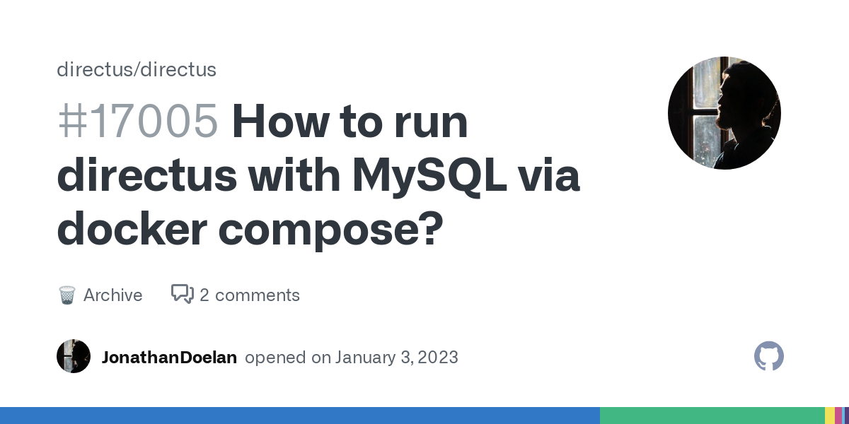

ログインエラー :データベースにMySQL(MariaDB)を選択した場合
directus:log
WARN: Some tables and columns do not match your database's default collation (utf8mb4_general_ci):
directus  | 		- Table "directus_webhooks": "utf8mb4_general_ci"
directus  | 		  - Column "headers": "utf8mb4_bin"
directus  | 		- Table "directus_files": "utf8mb4_general_ci"
directus  | 		  - Column "metadata": "utf8mb4_bin"
directus  | 		- Table "directus_fields": "utf8mb4_general_ci"
directus  | 		  - Column "options": "utf8mb4_bin"
directus  | 		  - Column "display_options": "utf8mb4_bin"
directus  | 		  - Column "translations": "utf8mb4_bin"
directus  | 		  - Column "conditions": "utf8mb4_bin"
directus  | 		  - Column "validation": "utf8mb4_bin"
directus  | [00:23:21] POST /auth/refresh 400 18ms
directus  | [00:23:21] GET /auth 200 21ms
directus  | [00:23:21] GET /server/info 200 26ms
directus  | [00:23:21] GET /translations?fields[]=language&fields[]=key&fields[]=value&filter[language][_eq]=en-US&limit=-1 403 19ms
directus  | [00:23:35] POST /auth/login 401 569ms
directus  | [00:25:56] POST /auth/login 401 534ms
directus  | [00:26:18] POST /auth/login 401 516ms
directus  | [00:29:22] GET /en/admin/login 404 18ms
MariaDBコンテナにコマンドオプションを追加。
docer-compose.yaml
  mariadb:
    container_name: mariadb
    restart: always
    image: mariadb:latest
    environment:
      MYSQL_USER: ${DB_USER}
      MYSQL_ROOT_PASSWORD: ${DB_PASSWORD}
      MYSQL_PASSWORD: ${DB_PASSWORD}
      MYSQL_DATABASE: ${DB_DATABASE}
    volumes:
      - ./db:/var/lib/mysql
    command:
                "--character-set-server=utf8mb4",
                "--collation-server=utf8mb4_bin",
mariadb Command-Line Client | Server | MariaDB Documentation

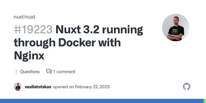

Nginxのリバースプロキシの設定で、以下のディレクトリへのアクセスをwssのポートへ誘導、docker-composeファイルでもそのポートを開放。
# For nuxt hmr
    location /_nuxt/ {
				proxy_pass http://172.22.0.1:24678;
				proxy_set_header Host $host;
        proxy_set_header X-Real-IP $remote_addr
        proxy_set_header X-Forwarded-For $proxy_add_x_forwarded_for;
        proxy_set_header X-Forwarded-Proto $scheme;
SyntaxError: Failed to construct ‘WebSocket’: The URL ‘wss://localhost:undefined/’ is invalid

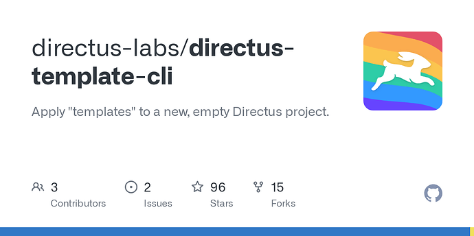

https://github.com/directus-community/directus-template-cli

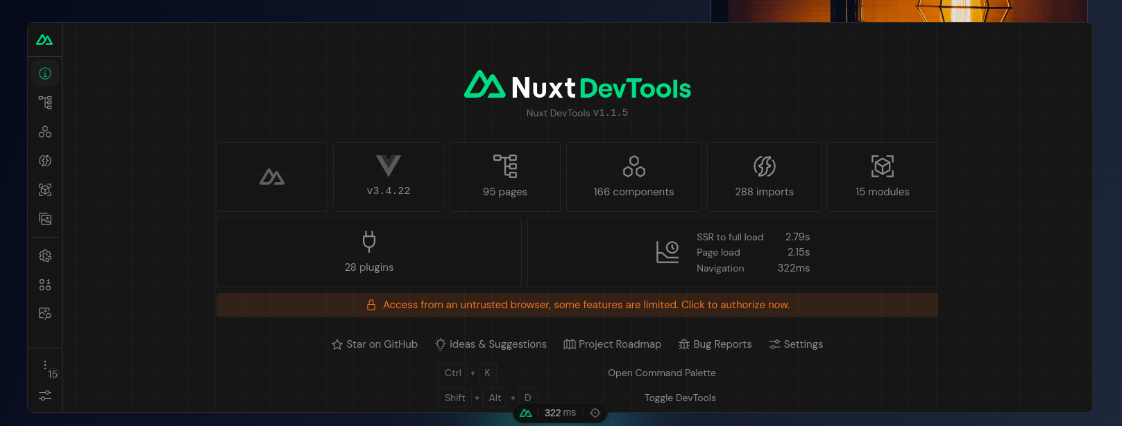

:warning: NuxtのDevツールを利用する場合には、必ずhttp://localhost:3000を利用すること。

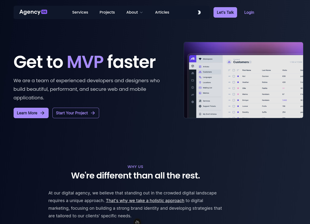

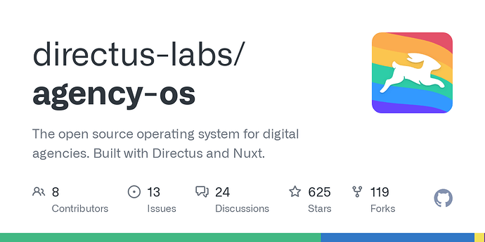

AgencyOS(テンプレート)のインストール
https://github.com/directus-community/agency-os

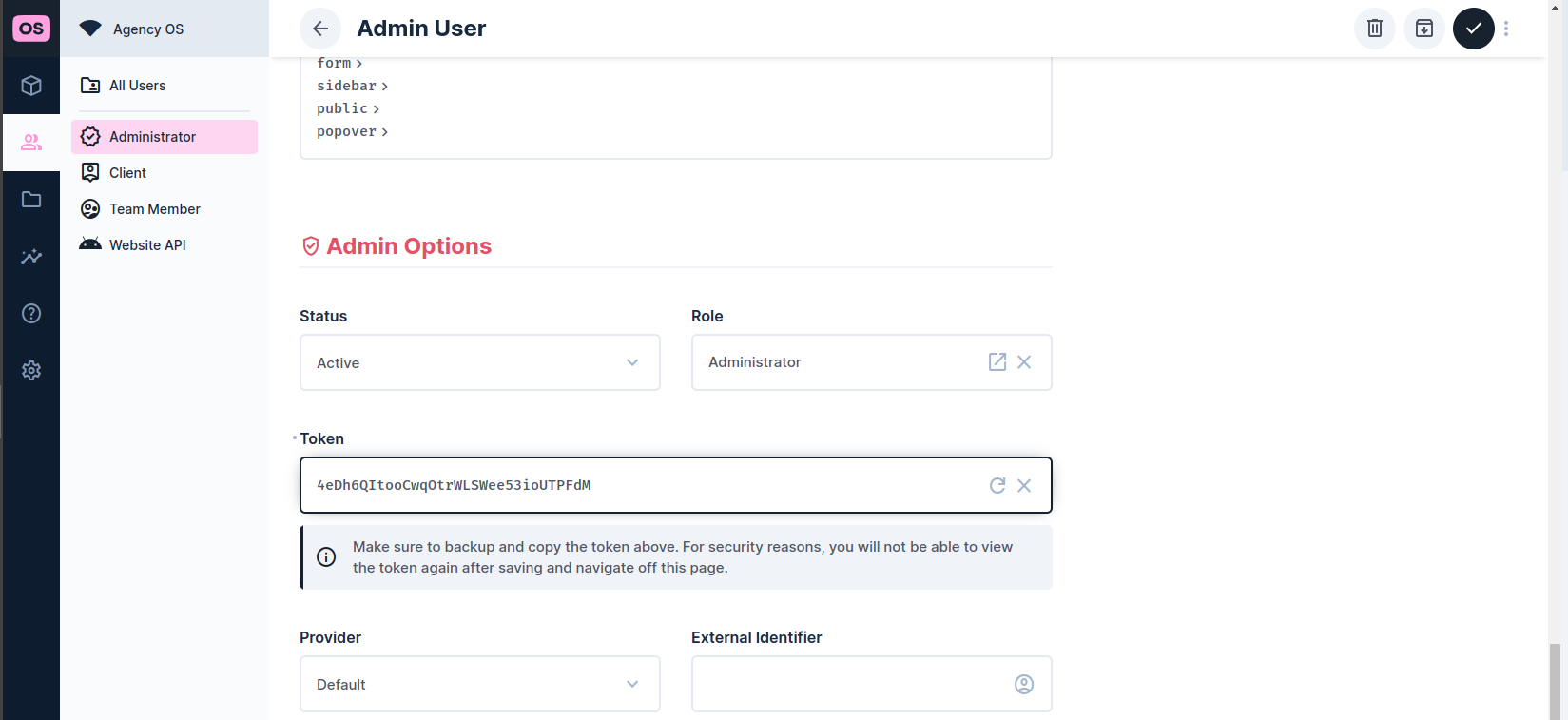

テンプレートデータのインポート
注)事前に管理画面でTokenを作成
注)インポート先のURLとしてdirectusコンテナのアドレス:ポートを指定すること
Directusコンテナ内でAgencyOSのテンプレートデータをインポート(JSONフォーマットデータに対応したPostgreSQLが必須条件)
$ docker compose exec directus sh
/directus $ npx directus-template-cli@latest apply
Need to install the following packages:
[email protected]
Ok to proceed? (y)
? What type of template would you like to apply? Official templates
? Select a template. AgencyOS
You selected AgencyOS
What is your Directus URL?: http://172.18.0.4:8055
What is your Directus Admin Token?: xxxxxxxxxxxxxxxxxxxxxxxxxxxxxxxxxxxx
Loaded Schema
Applying template - AgencyOS... ⣽
Loaded Roles
Loaded Folders
Loaded Files
Loaded Users
Loaded Dashboards
Loaded Panels
Loaded Data
Loaded Flows
Loaded Operations
Loaded Presets
Loaded Settings
Applying template - AgencyOS... ⡿
Loaded Permissions
Applying template - AgencyOS... done
Template applied successfully.
テンプレートフロントエンド起動
ソースをダウンロード・ディレクトリへ移動
$ git clone https://github.com/directus-community/agency-os.git
$ cd agency-os
.envファイルを作成
.env
# Directus Setup
DIRECTUS_URL="https://your-instance.directus.app"
DIRECTUS_SERVER_TOKEN="your_directus_server_token_for_server_only_routes"
SITE_URL="http://localhost:3000"
pnpmを有効にして関連パッケージをダウンロード・テンプレートを起動
$ corepack enable pnpm
$ pnpm i
$ pnpm dev

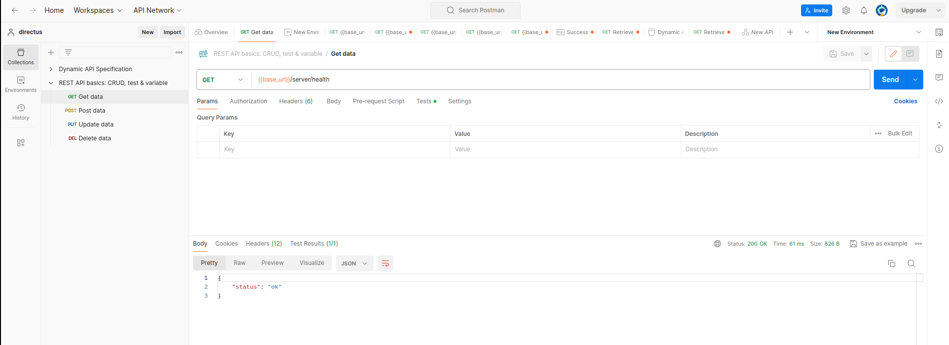

API
Request
REST
GET /server/specs/oas
GET /server/specs/graphql/
GET /server/specs/graphql/system
GET /server/ping
GET /server/info
GET /items/pages

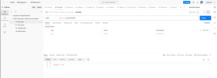

Postmanで確認
environmentのbase_urlにdirectusのアドレスを入力してAPIの動作を確認
Curlコマンドで確認

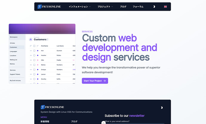

サイトのカスタマイズ
Nuxt.jsとTailwindによるフロントエンドデザイン
フレームワーク:Nuxt, Vue.js

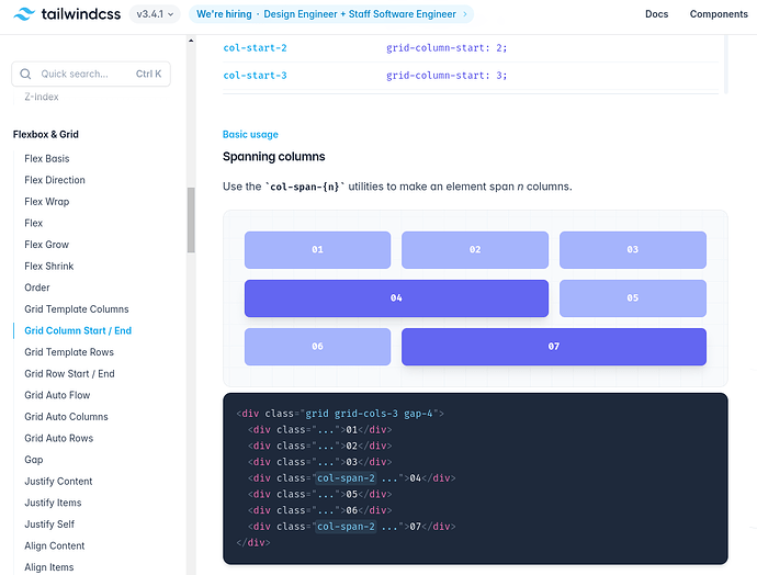

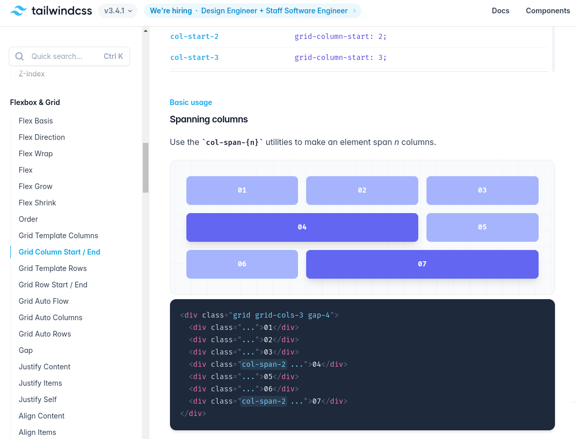

グリッド
フォームのビューモードをダークで固定
components/base/UForm.vue
		<div>
			<FormCustom
				class="grid gap-6 md:grid-cols-6 dark"
		</div>

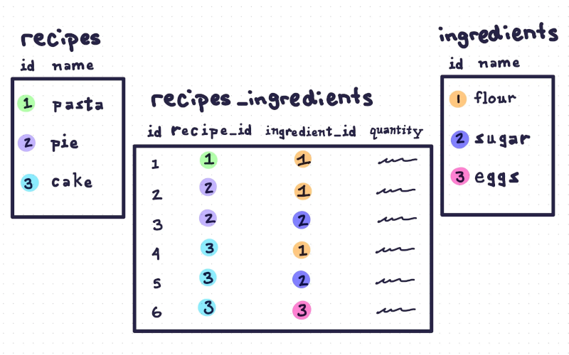

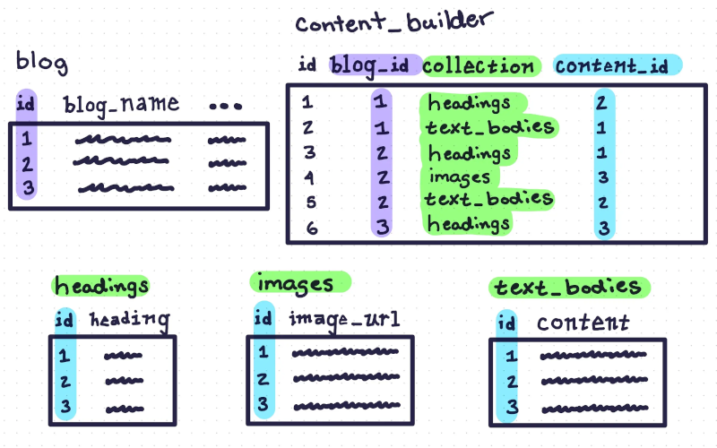

データリレーション
データモデルを構築する上で事前に理解が必要。
Many-to-Many (M2M)
recipes
- id
- name
- ingredients (An M2M alias field. Does not exist in the database, allows access to ingredients linked from recipe_ingredients)
recipes_ingredients (junction collection)
- id
- recipe (stores foreign key from recipes.id)
- ingredient (stores foreign key from ingredients.id)
- quantity (A "context" field. Stores other data associated with the relationship. These are optional.)
ingredients
- id
- name
- recipes (an M2M alias field, does not exist in the database, enables access to all the recipes related to an ingredient)
Many-to-Any (M2A)
pages
- id
- name
- sections (An M2A alias field, does not exist in the database. Provides access to items from page_sections.)
page_sections (junction collection)
- id
- pages_id (An M2O, stores foreign keys from pages.id)
- collection (An M2O, stores name of the related collection, for example headings, text_bodies, or images.)
- item (An M2O, stores foreign keys from headings.id, text.id, images.id, etc.)
headings
- id
- title
text_bodies
- id
- text
images
- id
- file
Nuxt DevTools
devtoolsのアクティブ/非アクティブ化(通常は開発段階 pnpm dev でのみ利用される機能なのでアクティブのままを保持)
agency-os/nuxt.config.ts
devtools: { enabled: true or false },

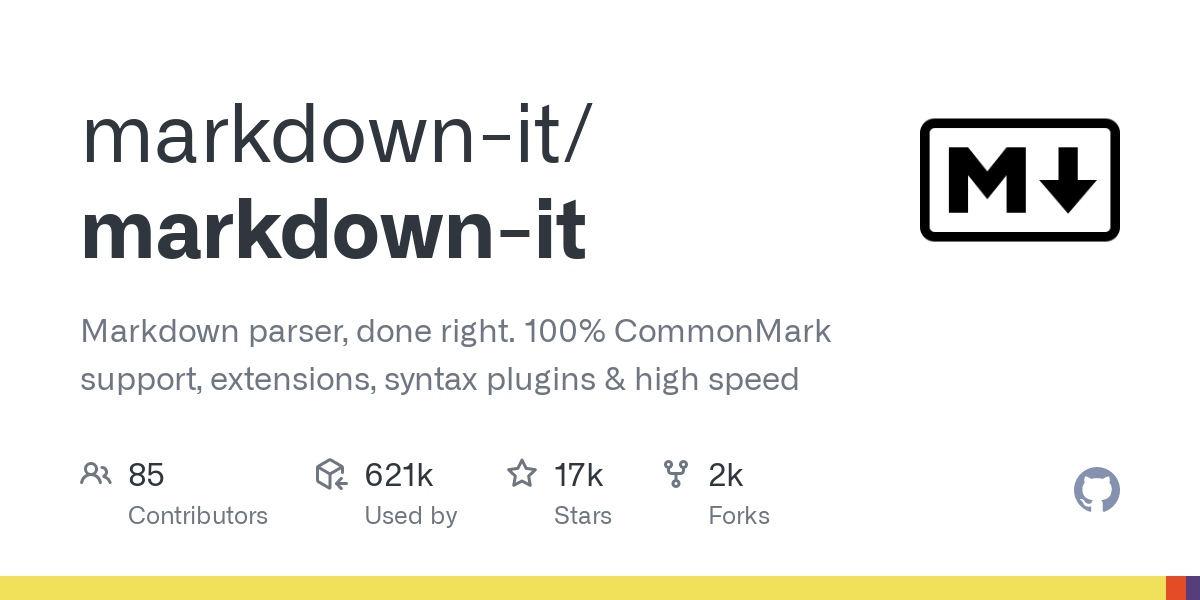

Markdownフォーマットのレンダリング
markdown-itモジュールのインストール
依存関係から@directus/typesのアップデート
# pnpm install @directus/[email protected]
markdown-it, @types/markdown-it のインストール
# pnpm add -D markdown-it @types/markdown-it
役割の違い
  • markdown-it: 実際の Markdown パーサーの実装を提供します。
  • @types/markdown-it: markdown-it の型定義ファイルを提供します。

directus-template-cliのv.11への対応
注)既に対応済のため下記は参考扱い
一度テンプレートをバックアップし…
# npx directus-template-cli@beta extract
上記テンプレートを読み込みます
# npx directus-template-cli@beta apply

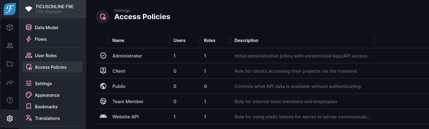

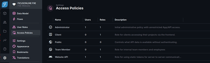

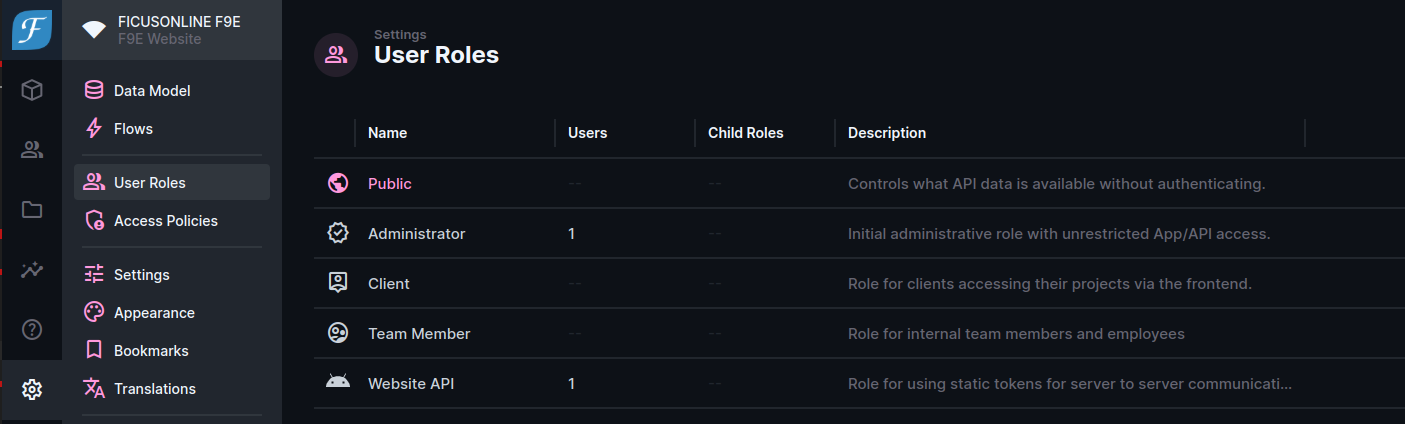

Directus v.11で変更となったポリシーに基づいたアクセス制限
https://docs.directus.io/blog/understanding-policy-based-access-control.html
ユーザロールとアクセスポリシーへの対応
