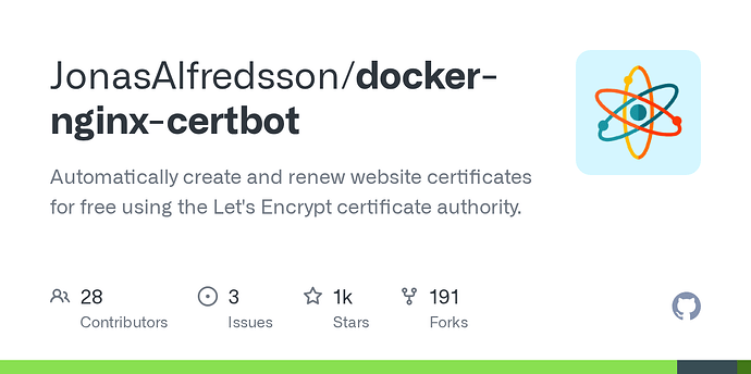

Nginx+Certbot Docker
Github
Docker hub
https://hub.docker.com/r/jonasal/nginx-certbot
