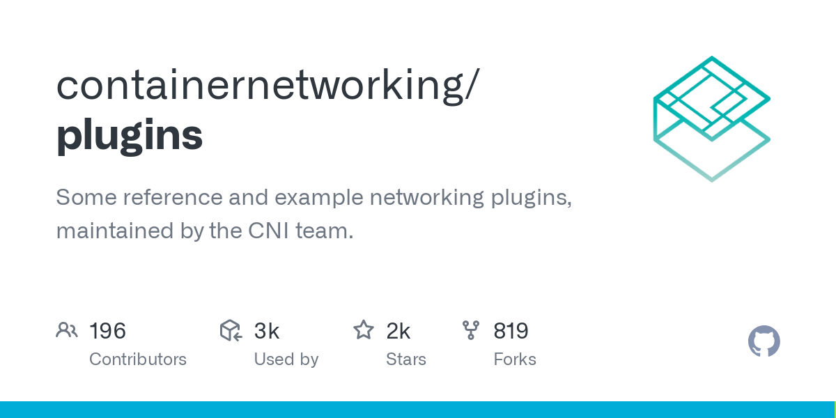

CNI (Container Network Interface) のインストール
$ CNI_VERSION="v1.7.1"
$ curl -L -o cni-plugins.tgz https://github.com/containernetworking/plugins/releases/download/${CNI_VERSION}/cni-plugins-linux-amd64-${CNI_VERSION}.tgz
  % Total    % Received % Xferd  Average Speed   Time    Time     Time  Current
                                 Dload  Upload   Total   Spent    Left  Speed
  0     0    0     0    0     0      0      0 --:--:-- --:--:-- --:--:--     0
100 53.3M  100 53.3M    0     0  4017k      0  0:00:13  0:00:13 --:--:-- 4274k
$ sudo mkdir -p /opt/cni/bin
$ sudo tar -C /opt/cni/bin -xzf cni-plugins.tgz
$ ls /opt/cni/bin
bandwidth  bridge  dhcp  dummy  firewall  host-device  host-local  ipvlan  LICENSE  loopback  macvlan  portmap  ptp  README.md  sbr  static  tap  tuning  vlan  vrf
